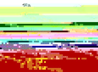

Hi there,
Can someone help.  I am looking at the pin locations and trying to determine which is left input, left output, etc.  I have done some investigating but the website that I am consulting looks like the pin outs do not correspond with the wires of the Quickie.
Looking at the attachments and trying to figure out the wires going to it in the Quickie 1.1 I think I have it as:
5L - going to pins 3, 6  =  Ground   (Why is it necessary for this wire to be attached to both 3 & 6 if they are grounded - ie.  why is pin 6 double grounded when it is also attached to A RCA ground?)
A RCA ground - pin 6   = Ground   (I guess these don't matter if it is Left ground and right ground)
Terminal A - pin 4        = Right Input ?
Terminal B - pin 1        = Left Input ?
A3 - pin 5                    = Left Output ?
B3 - pin 2                    = Right Output?
I am upgrading to an attenuator (VAL 100k) and want to make sure I am configuring it properly.  Apologies if I should know more about this!
Thanks for the feedback....Dave

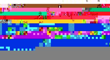

I understand your confusion Dave! - It took me awhile to finally get this one figured out. See the attached photo. All these stereo pots are pretty much wired the same. Going from left to right viewing it upside down, "input, output, ground". The next thing you need to do is become versed in what your plus minus and ground is on the Q. Hint "the ground is the common wire between all the inputs". Enjoy - Eric
