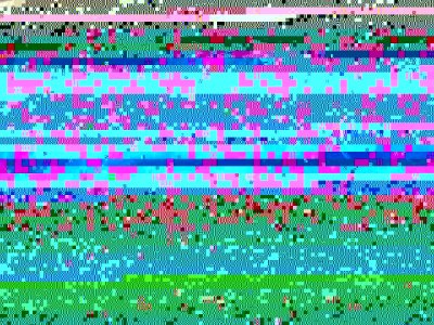

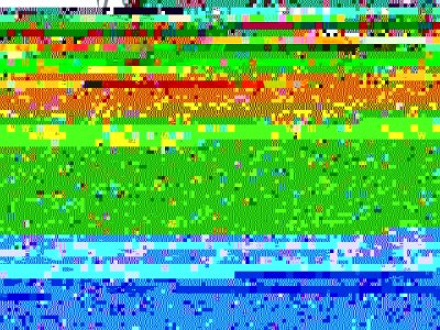

Bought a cheap ebay ($80) drill press. Wow what a difference. Drills holes like a knife thru warm butter! What would take me a minute with a hand drill comes out in seconds with much better accuracy and no scratches. Check the 2nd photo to see the nice scrape the hand drill made. Highly recommended if you plan on drilling a few holes. Using a cobalt stepped drill bit too. Its pretty small and portable...

Greg. Yes the cobalt bit is nice. But even in a hand drill it was sliding.
