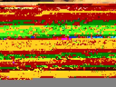

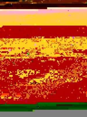

Just finished my quickie, pretty much stock except I put the batteries on  bottom for a nice clean look
and lined up all of the slots on the screw heads.
See attached pictures.

Nice looking piece you have there. Your chassis plate looks like it is moving liquid. I was going to mount the batteries on the underside of mine but ran into issues with the way I wanted to build the cabinet. I ended up leaving them up top, but plan on building a cover for them.

Yeah, I will have to notch out the wood where the D cell holders are.
