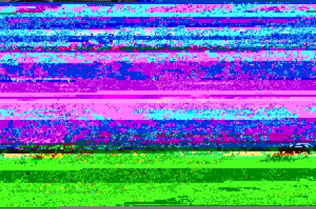

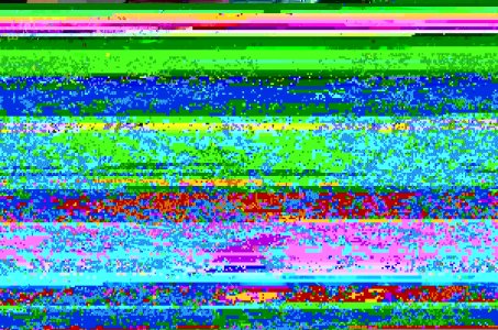

Reply #4 on: October 11, 2013, 06:23:26 AM
OK here are a few photos showing my lack of photography skills
    • Posts: 20286
Reply #5 on: October 11, 2013, 06:52:12 AM
So, 50V out and 5V on Kreg on the center board indicates that the middle 12AU7 isn't being permitted to draw any current.
This is consistent with both sides, so I would quadruple check the transistor positions and orientations.  Something on both sides is sucking down a ton of extra current!
