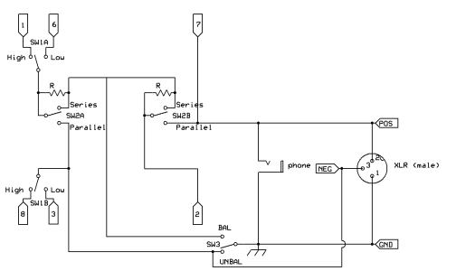

Right, i have a standard TRS and XLR connector installed, TRS is wired to + and Gnd on each impedance board, XLR is wired to + and - on each impedance board.
I've been studying the PCB trying to work out what the Balanced/Unbalanced switch is doing and its just making my head hurt.  All i can figure out is it adds the two resistors into the path?
What i'm really trying to understand is how the switch will effect the TRS or XLR socket in either position.   For example am i right in saying the switch will have no any effect on the standard TRS + and Gnd wiring, it only switches the - rail used on the XLR socket from balanced to unbalanced?
Mark
    • Posts: 5908
Reply #7 on: November 18, 2013, 05:43:24 AM
Here is the wiring diagram, if that helps.
There are two windings, both tapped. SW1 chooses which tap is used; SW2 chooses whether they are in series or parallel. If they are in series then the centertap is available for balanced ground; but if they are in parallel there is no center tap so one is created with two resistors.
In theory, balanced operation does not need a ground reference, but in practice I feel all headphone wiring should be referenced to the safety (chassis) ground.
It took me along time to come up with this simple diagram, and it made my head hurt, too!  :^)
Incidentally, it is important that both windings be used equally; otherwise the treble response suffers.

I think i am slowly getting my head around this, Paul can you please confirm if the following are true or false,
-With 4 & 8 ohms the windings are in Parallel, 16 & 32 ohms the windings are in series.
-When wired in parallel the center tap is devised via resistors from each winding, and when wired in Series the center tap is the link between both windings.
-When in unbalanced mode the output transformer negative rail is tied to chassis ground so GND and NEG become the same, and the center tap devised above is left floating.
-When in balanced mode the center tap devised above is connected to ground, and the transformer negative rail becomes the NEG tap for balanced operation.
-With an XLR jack, if the switch is set to unbalanced mode its going to function no different from a regular unbalanced TRS jack as the negative points become grounds.
-With a TRS jack, if the switch is set to balanced mode its only going to be connected to half of the output transformer as the ground rail is connected to the output transformer center tap, not the negative rail?
Now i just need to figure out what the optimum configuration is for headphone only use in balanced and unbalanced modes.  i.e Balanced with 300ohm load (XLR), and unbalanced with 32ohm loads (TRS).
-I've read the lower the ohm setting the lower the noise floor.
-I assume 16 & 32 ohm mode is preferable for balanced operation due to the real center tap vs the resistor devised center?
-Manual recommends 32ohm setting for headphone only use, would love to know the reasoning for that?
Thanks again for your patience, i have almost finished this build and will promise to stop bugging you guys :-[

mcandmar, you pretty much have it. Here's the only one that is actually more complicated:
"-With a TRS jack, if the switch is set to balanced mode its only going to be connected to half of the output transformer as the ground rail is connected to the output transformer center tap, not the negative rail?"
* TRS jack, set to balanced, and at 16 or 32 ohms: Then you are actually listening to only one of the secondary windings, making it effectively a 4 or 8 ohm winding. If you had 4 or 8 ohm headphones, you would lose a couple octaves of treble due to the increase of leakage inductance from incorrect usage. With headphones above 16 or 32 ohms, this effect is pretty much gone.
* TRS jack, set to balanced, and at 4 or 8 ohms: Now the windings are paralleled for proper transformer operation, but the resistors are in the circuit. One resistor is across the headphone jack, and the other one is in series with the winding voltage. Effectively you get half the voltage, with a source impedance of 30 ohms. This reduced output could actually be useful for high-sensitivity low-impedance TRS phones making them more compatible with high-impedance balanced phones. But in some cases the additional source impedance will reduce the damping of the headphone and make a more wooly or bloated sound.
