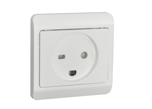

All UK style plugs have a fuse built in, though that means fuses are usually doubled up as almost all appliances these days have a fuse built in.  We also have three pin plugs similar to Australia with a dedicated earth pin.  The thought of only having two pins and no fuse just scares me.
My favorite plug socket has to be Denmark, doesn't that just make you smile  :)

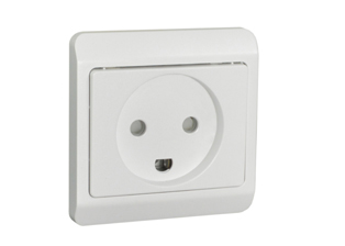

and their "Hospital Grade" version..

I like South Africa's outlets.  They are all 240V/35A.  They are also not recessed at all, so as you're plugging a cord in, the live pins are pretty easily touched.  To remedy this, every outlet has a switch on it for safety considerations...
