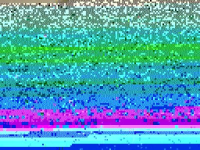

A few years back, I bought a pair of unbuilt Paraglows missing bases and top plates. They came from someone that had trade for the years prior. Neither of us ever started to build. A amp building buddy stepped in for me a said, heck, let's get these built. Last night I saw the first completed amp. I'm getting excited to try them with my 604's!
Pictures will follow soon.
Here's the parts shot.
(https://forum.bottlehead.com/proxy.php?request=http%3A%2F%2Fi29.photobucket.com%2Falbums%2Fc254%2Fejfud%2FParaglowKit.jpg&hash=332cc5d8e73fdc0bb4985f9e63ba0caa6482f311)

Here they are running in the builders system.
Reply #2 on: November 27, 2013, 11:21:40 AM
So Elmer's middle initial is J?
That is an interesting setup in the builder's system.  As long as there are no tiny fingers and no small furry creatures to get to the high voltage hiding under the plate.
It would make it easy to blow out cat hair.

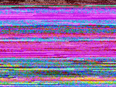

Offline Ejfud
    • Posts: 7
Reply #9 on: February 02, 2014, 09:18:49 AM
Underside shot
Offline RPMac
    • Posts: 221
Reply #10 on: February 02, 2014, 10:05:37 AM
Thanks for the pics.
I was interested to see the iron layout.
Any insights to the positioning?
Lots of room for some big upgrade caps.
