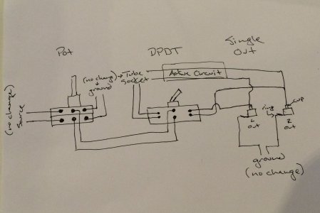

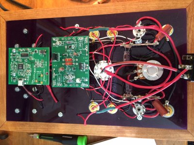

My main questions are: Do I need to install another set of outputs or can I just wire volume pot>DPDT>existing single output? Is the DPDT I currently have in there the correct kind of switch for this application? I know I'm going to explain it poorly, so I attached a drawing below with what I'm thinking will work. I've also attached a picture of my present arrangement.
While I'm messing around, I'm also thinking about swapping a Goldpoint 50K stepped attenuator for the stock pot. Will this be a good fit in this application? Goldpoint recommends 25K for both tube and passive preamps, but PJ - it sounds like you'd vote for 50K?
All of this will eventually run out to either a SEX or Paramount (TBD).
Surely appreciate any and all help here!
EDIT: I should qualify that I plan to remove the current switch and restore the direct connection from the source selector to the volume pot. Also, I noticed in my drawing that it looks like I wrote "no charge" it is, in fact, "no CHANGE".

Reply #4 on: August 14, 2015, 02:06:37 PM
A simple switch that swaps the input to the tube grids with an output to the output RCA jacks might work.  But I am concerned with the open grids of the tubes.  I would ground the inputs to the grids at the same time as switching to the output RCA jacks.
It might work either way, but if the tubes oscillate because of the open inputs then you get that on top of the passive output.

Grainger, thanks so much for the feedback. Reporting back here. Finally got around to taking this on this morning. There's good news and bad news.
Good news first, Valeb attenuator went in super easy after about 5 minutes spent with a pocket knife widening the mounting hole. With my switch in the active position everything sounds great and I think the attenuator was a nice upgrade in and of itself.  8)
Bad news now.  :-\
Quote
This does indeed appear to be a problem. I ran the output from the attenuator to the switch and then straight to the solder cup of the output jacks. When the amp is in this "passive" setting, it creates TONS of hum (way louder than the music), so it seems grounding is an issue.

Reply #6 on: August 22, 2015, 10:15:03 AM
Hmmm, that might be the open grid feeding noise through the circuit and that appearing as well.
I was writing about grounding the grids but I realized that that would also ground the passive output.  I'm going to have to think on it.
One way to eliminate this is to lift the output from the output capacitors when you go passive.  Do you follow me?

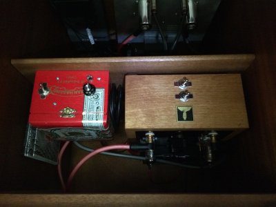

So I put in the second switch to "lift" the caps from the outputs when I switch into passive mode - sweet success. I know it compromises some of the simple elegance of the circuit, but it fits my needs a lot better.
The passive mode obviously doesn't sound as good as the full active quickie, but that's to be expected and works for me - the main point is to have jams at a party or while I'm doing chores or whatever.
Thanks for everyone's help, I really learned a lot during the project.
Here's a pick of the quickie with it's new facelift.
