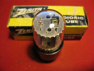

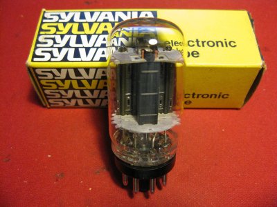

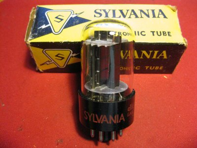

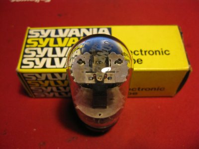

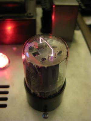

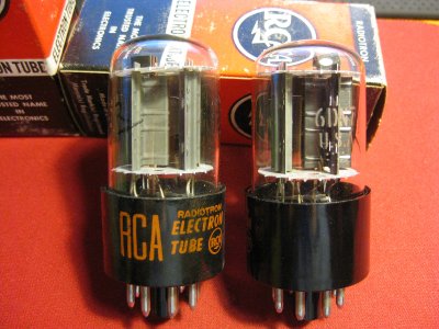

Part 1: Glowing bottles.  The general consensus is that there is little to no difference between tubes from different manufacturers.  Its pretty safe to say tube rolling isn't a thing with 6DN7's. There is in my opinion one or two exceptions to that rule being the Sylvania Black Plates, and Tung-Sol tubes.  Sylvanias can occasionally be found re branded under a few other labels such as International Servicemaster, Realistic International, Fivre, and Mullard.
So far i have collected sets from GE, RCA, Zenith, Fivre, National Electronics, International Servicemaster, Mullard, Tung-Sol, and Sylvania. I would go so far as to say 9/10 tubes are the same tube regardless of the manufactures stamp. The Sylvania however are clearly different in their construction, easily recognized by their cut away top support disk.

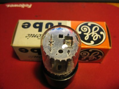

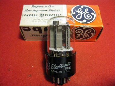

There are a few key differences in tubes so i have attached a few images to illustrate the point. Most are regular grey plates however some are black plates, and some have one grey and one black plate. And then the same three variations can be found in regular and coin base packages.  You may occasionally come across tubes with an exposed heater winding on the top which are wired in series instead of in parallel, as shown in the Zenith tube below. Overall my personal preference is for the Black plate Sylvanias.
Another alternative is the 6FJ7 tube which is electrically identical to the 6DN7 but packaged in a 12pin Compactron base vs the regular 8pin Octal, as shown in the last picture. A full write up on the adapter can be found here --> http://bottlehead.com/smf/index.php?topic=5811.0

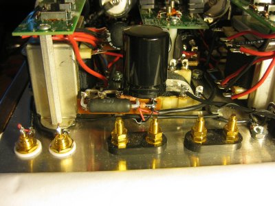

Part 2: Heater supply cap and resistor.
-Capacitor: As discussed further on in the thread doubling the capacity of the smoothing capacitor serves to half the ripple on the supply but has little to no audible or measurable effect on the noise levels of the amp. The capacitor i have used is a 22000uf Panasonic TS similar to the rest of the power supply caps, and physically the same size.
10000uf 10v - Lelon REA 85c 20% H010(M) 35mm x 18mm x 7.5mm - 2430mA
22000uf 16v - Panasonic TS-H 85c AECOS1CP223CA - 25mm x 35mm x 7.5mm - 6100ma
- .1r Resistor: My hatred for those ugly wire wound cement blocks was my motivation here to source a Dale for no other reason than its not a cement block.  There are two versions of these being inductive and non-inductive, i opted for the non-inductive version.
- 100r Resistors: As suggested by PJ connecting two 100r resistors in series between the + and - terminals and grounding the center point serves to balance out the voltages on the DC side of the heater circuit.  This simple modification seems to have a considerable effect in reducing background hum and is highly recommend if you are having issues. Connect one 100r resistor between terminal C1 to C3, and C2 to C3 as shown in the attached pic.

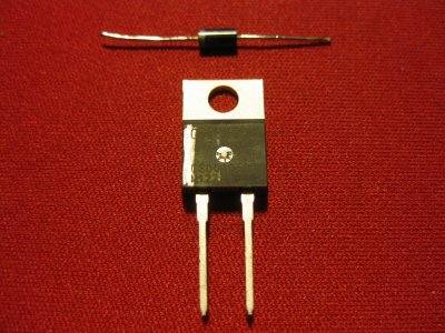

Part 3: Voltage doubler diode upgrade.  Replacing the two UF4007's with Cree CSD01060A as used in the Mainline.
I then took a snap shot of the noise at the headphone socket before/after and the difference was so small i couldn't see any difference between them. They work, and presumably better, but i really cant quantify it. As they say in motorsport, every little bit helps.

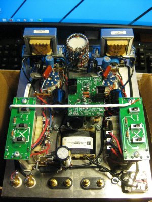

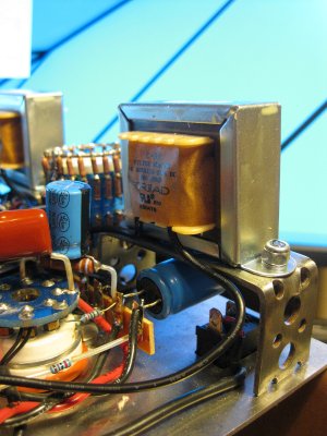

Part 4: Headphone jack resistors / Power supply chokes,
As suggest by Doc.B adding two 120ohm resistors in series with the headphone jack greatly reduced the background noise/hum on the amp making it almost silent. Refer to heater supply 100r resistors above.
Installing the two C3X chokes in place of the 680ohm resistors in the main power supply removed the remaining 10% of background hum.  Having listened to the amp at length with various headphones i cannot hear a thing, just a lovely black background which makes a world of difference to the clarity/detail. Really happy with the result ;D
Specs for the C3X are 10Henries, 50mADC, 500ohms. They both measured ~470ohms on my meter however the power supply voltages measured before/after were all within three volts of each other.
As for physical placement, it would be possible to locate them to the side of the tube sockets on standoffs but i wanted to leave a bit of room around that area to replace the two capacitors in the future.  The only other place i could find was the front edge of the chassis so they sit below the headphone socket and power switch.  Obviously there are no issues with hum from their placement.
For the bracket i used a piece of steel strip i had, crudely bent to shape in a vice to fit around the various components and held in place by the volume pot.  I lucked out as i had a washer under the volume pot to space the knob flush with the top plate that happened to be exactly the same thickness as the steel strip so it all just fell into place.  Gave the bracket a quick sand/spray with clear coat to prevent rust and called it a day.

FWIW, I'd put the UF-4007's back in.  The Crees don't always do well being wired in a PTP circuit, as they have that metal tab that can cause quite some problems.
Don't worry the live backing tab was one of the first things i noticed in the datasheet, i have them well protected with heatshrink and tie wrapped to the plastic standoff for the C4S.
