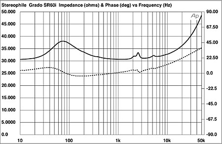

The IHF/IEC standard of 120 ohms output impedance for headphone jacks is great for equalizing the level over the usual range of 32 to 600 ohms.  Headphones that have a problem mostly do so because they have an impedance peak in the bass (I believe centered around 100-200Hz, more often than not). This peak combined with a high output impedance causes an elevated level in that region. It's not huge, a few dB, but can be quite audible. (Not everyone hates it.)
I speculate that this peak is a result of trying to get the most sensitivity possible. Technically that would reflect having little mechanical damping and relying on electrical damping of the fundamental mechanical resonance. The reason for seeking greater sensitivity is that portable devices usually cannot achieve the 5vRMS output that is also part of the IHF/IEC standard - they are limited by the low-voltage battery.

AFAIK most Grados have this peak ~100hz, and they are known for running fine directly off portable gear like iPods.  Most of my own opamp based amplifiers are setup for unity gain so they all run Grados with less than 2v.
