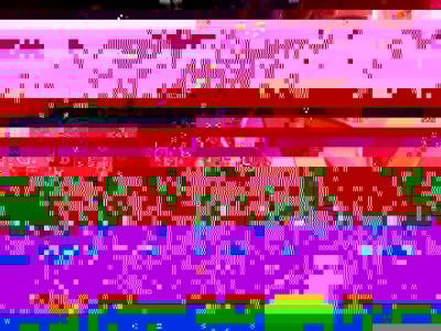

We're not quite sure what you mean by swapped between boards.   The r1 resistors are 237 ohms.  There is one on board a and on board b.  Also attaching an image of the resistors.
Reply #5 on: January 14, 2014, 08:19:10 AM
He means that you may have an R1 resistor from one of the small boards on the big board and vice versa.

Reply #6 on: January 14, 2014, 09:06:52 AM
We rechecked the resistors as mentioned and they are correct.  There's a different one in the big board and two of the same ones on the smaller board.
