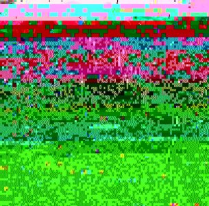

Attached is a (rather poor) image of the front portion of the Tode.  It was a fun kit to build and not particular difficult.
Will I hate myself for routing the A-C filament wires in parallel with the signal wires from A to B tube?  The filament wire is shielded so it should be okay, but???
