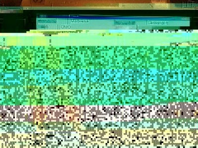

Woohaa i after a long evenings assembling the Crack got my reward... i got to the final test =)
I'm posting a picture of the last measurement and i hope you guys think the values are OK?

What exactly are you measuring there?
If that's the output, it looks normal, and will be less than 1/3 of that.

That is the last step in the guide when you measure on the phone output when you start up the Crack.
All the voltage's was OK, the only ones that wasn't exactly right was the pins that were supposed to have 90V. My Crack had about 75V on all of those pins.

Would this be a trace off a storage scope that shows the rise and drop of the DC at the headphone jacks?
The spec says it should be no higher than 9V, it isn't.
It also drops to essentially zero at 14s.
