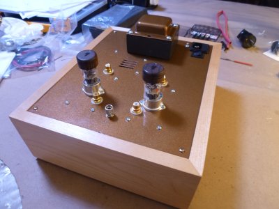

when i finished i noticed a booboo.  i accidentily burned the side of one of the 0.01uf caps with my soldering iron.  it was bad enough that i could clearly see the foil.  i don't know if it caused any problem, but the voltage at terminal 13 is normal.  i just taped it up with black electrical wire.  anyhow, maybe i can ask eileen to give me one when i ask her for the 2 resistors that were shorted in the integration kit.
thanks again paul, for the excellent equipment and support  :) ;) .
Offline wesleyHK
    • Posts: 29
Reply #13 on: February 25, 2014, 03:58:52 PM
 ;D  here's a pix of it.
