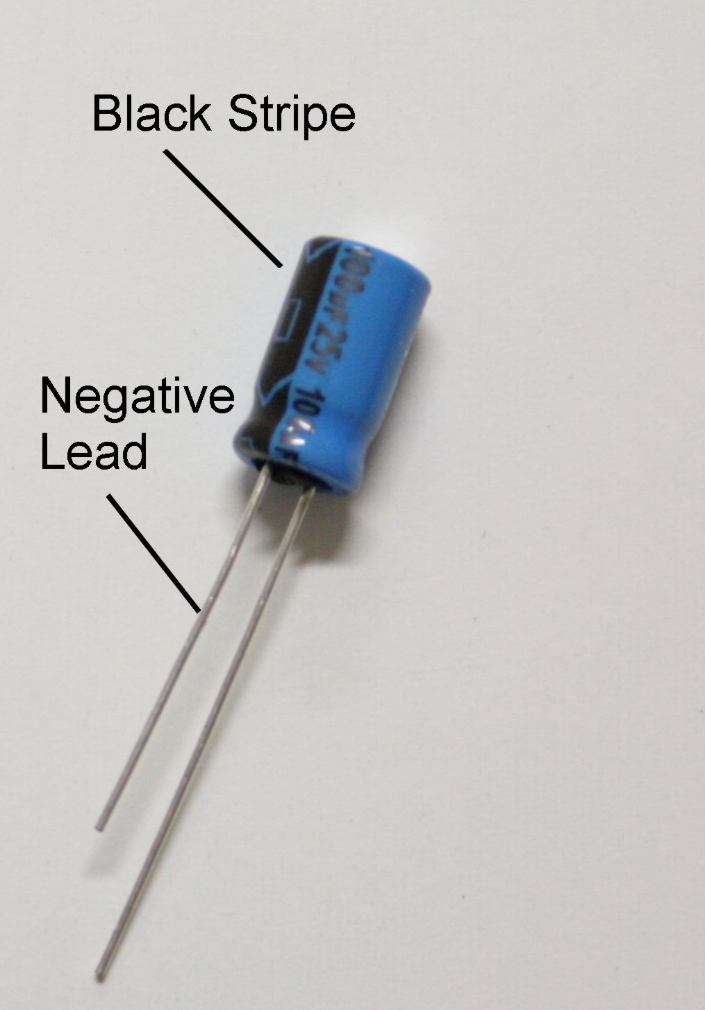

Second thing is about the direction of the capacitors. Which are the 220uF/250V and the 100uF/160V ones. I don’t understand what the “striped side” mean? Sorry English is not my native language.  For 220uF/250V, does it mean the side that has grid grooves on the root of the lead? For 100uF/160V, does it mean the side that has the shorter lead?

The striped side of each capacitor is the side that has the marking running along the capacitor.  (See image)
