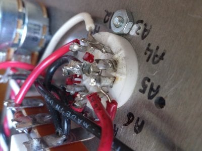

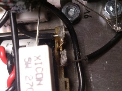

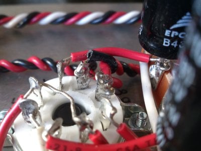

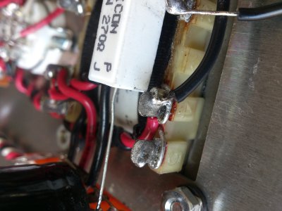

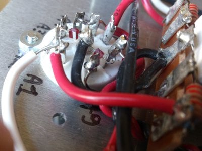

I've finished the building and the resistance check is ok, but when I turn the amp on to check the voltage, the tubes don't glow at all and fuse insn't blow. I've searched throught the forum and i found that it may be bad solder joints on transformer terminal 4 and 5 or tube pins B8/B7/A4/A5 and B9 so  I've check all solder joints but i have to admit that i am beginner in soldering so here some picture... Thank you

First, to address what you mention in your post:
What kind of solder are you using.  I  don't like the looks of most of your solder joints.  They are dull.
For instance, in the last picture the left LED, left lead, the solder joint at the tube pin has a lot of brown on it.  The tube pin to the right of this one shows the wire black and tube pin looks rusted.  There doesn't seem to be much solder on the joint mentioned in the last sentence.
Of course there are a number of places a newbie can have problems.  The diodes must be oriented properly (white banded side is the key), including the LEDs (silver banded side is the key, and the two on the 12AU7 are right).  The capacitors must be oriented properly, the white striped side is the key here to.
Next, the place to start is any voltage that is 15% out of spec, plus or minus.  Post the terminal or tube pin number, the expected voltage and your voltage.

I would hypothesize that you have accidentally cut one of the power transformer wires leaving power transformer terminals 1 and 2.
You'll have to look pretty carefully for them, they wrap around the base of the terminal a few times, then disappear under the black transformer bobbin tape.

The upper wire in that photo looks severed to me.

The thing to do is measure across the two terminals to see if it reads open
