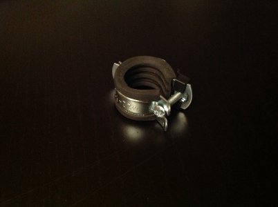

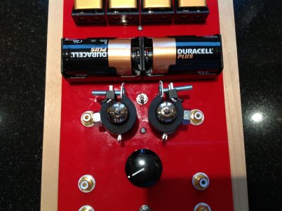

I have three different sets of tubes, the RCA that came with the kit, Telefunken's and Mullard's. The Mullard's have the least microphonic. But it does not go away, it is just a little less. In addition I dampened the tubes using water pipe clamps.

Great idea with those water clamps!  Do they get hot enough to melt?

Reply #5 on: March 02, 2014, 10:27:39 AM
The 3S4 (DL92) tubes stay practically cold in the Quickie.
Offline aragorn723
    • Posts: 1050
Reply #6 on: March 02, 2014, 04:53:45 PM
Are those D cells backwards?

Reply #7 on: March 02, 2014, 08:35:51 PM
Yes and no. The manual had a mistake, which I had not rectified properly then. One solution was to put the D cells in backwards. I fixed this since  8)

Update.  Moved the whole system to a better place.  No extension cord for power, better isolation for turntable, and Quickie.  Microphonics have lessened and I think I can get further improvements by putting a layer of silicone between the chassis board and wooden case for the Quickie.  I still have some clicks, but they have changed since the move so I imagine it is probably some stray RF (as suggested above) .  Thanks for all your help.
Question for Zimmer64:  How to you use those water clamps on the tubes?  Won't the tubes break? Or is their padding of some sort between the tube and clamp?

Reply #9 on: March 03, 2014, 05:34:32 AM
They have a rubber ring on the inside and I tightened them gently by hand.
