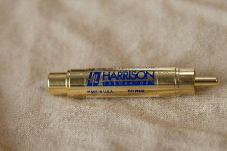

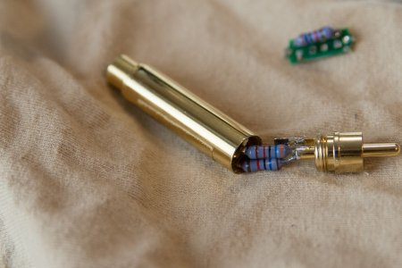

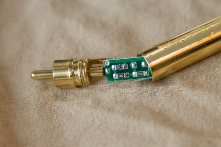

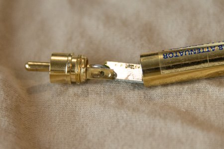

My Harrison Labs attenuator mod was a success.  I can hear a difference in detail with my headphone amp.  Still can't try out with the Bryston as my speakers are still not here (shipping next week though!).
My mod was to change out the resistors in the Harrison Labs -12db attenuator so that impedance matched my Bryston amp exactly.  The attenuators had a 9k ohm impedance and my amp is 50K.
1st pic is the unopened attenuator.  Unscrew the male rca end and you get the 2nd picture.  I have to say that the guts of this attenuator are quite nice with good parts and layout.  Note the ground plane behind the resistor board in pic 3.
I tried to remove the chip resistors and attach the 36k series and 16k parallel Shinkoh 1/2W resistors to the board.  The board traces and pads are too delicate and they broke. I then attached the resistors as in pic 4.  You may not be able to see well, but the center connection from the female socket is attached via a wire that BARELY reaches the brass housing.
In the end, it worked well.  And these resistors do sound great.  Maybe its the impedance change, but there is more detail now.  Its subtle, but I can hear it right away with my headphones.
