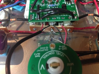

I also checked terminals 8 & 10. I have continuity between the volume attenuator & T8 &T10. I also reheated all the solder joints at T8 and T10 as well as anywhere else that connected to ground, so I don't think it's a cold solder joint.

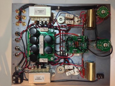

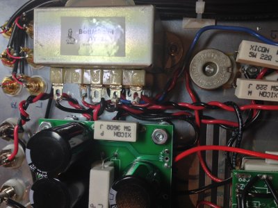

I posted some pictures of my build in case that helps. Any other likely culprits to look for?

You have an empty "K" solder pad on the power supply board?

Doh! You were right. I missed that solder. Funny, it didn't affect my resistances or voltages. But after soldering, the buzz in one channel is gone.
