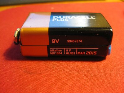

Reply #14 on: September 25, 2014, 01:33:07 PM
In my experience they go bang.  Here is another i found in a cable tester in work, it too had gone bad and built up enough pressure to pop the end caps out.
