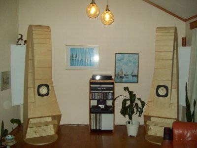

By remote chance, just wondering if anyone came across a plan for these back loaded horns ? Provenance is from Europe, Norway to be more specific. I saw a note somewhere that they were named speaker of the year....I don't know which year.

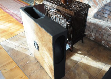

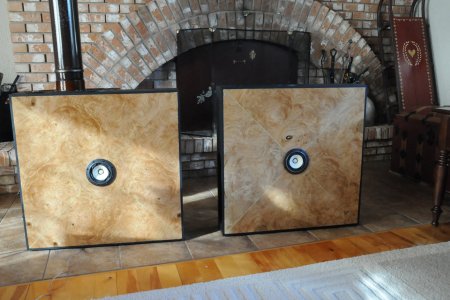

That is a fantastic source of information ! Thank you so much for the reference. This winter, I built these Cornu Horns for my son. I was surprised by the quality of the sound. The speakers are Fostex.

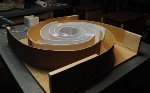

I followed the method outlined here:
http://sebastian-pitkanen.blogspot.ca/2006/07/cornu-spiral-copy-horn.html
I found it difficult to make the spirals using the material described; so, I made the initial inside curves using thin sheets of styrofoam, - then used 1/8" plywood for the longer curves. The foam was scored with a sharp knife every 1/4 inch or so to render it flexible. A glue gun is a must.
Instead of leaving the sides open, I used half inch thick solid pine and made four openings. The flat black paint makes four side openings disappear to the eye. The pine side sheets also make the unit very solid, not flimsy at all.
I did the front with burl wood veneer.....basically four identical triangles cut to size with the speaker as the focal point. Finished the veneer with hand rubbed Minwax poly.
