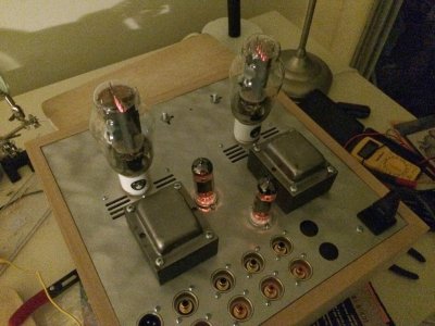

Unfortunately I don't recall what the tube looked like before I put it in.  I am sure I didn't force it in though.  I've attached a picture of the tubes.  I think the one on the left is toast.
Reply #4 on: March 13, 2014, 08:48:31 AM
Yup, butter it now, it is toast.
« Last Edit: March 31, 2014, 02:59:37 AM by Grainger49 »
Reply #5 on: March 13, 2014, 08:56:35 AM
That's such a shame :'(   If it were me i'd set it on my mantelpiece as an ornament.
    • Posts: 9756
Reply #6 on: March 13, 2014, 09:23:30 AM
Yes, that tube is dead. Send it back to us so we can get a credit from the distributor and we will send you a brand new one.

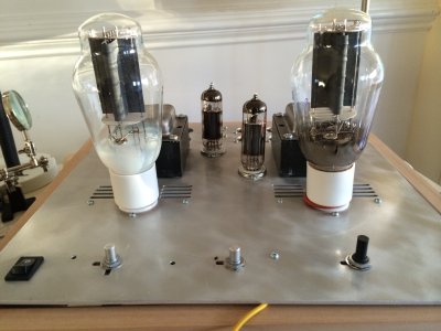

Well, I've made a step forward, but not all the way there yet.  Got the new tube, put it in, and powered the BeePree up.  Joy!  Glowing tubes!
So I put the pre-amp into my stereo.  I get sound out of one channel, the B side, but not the other, A side.  I tried swapping tubes and changing inputs and the sound stayed on that left side.  When I swapped the outputs the sound did switch to the right speaker.
So now I've got to figure out what's wrong with the right side of the BeePre.  I'll re-heat joints and measure voltages (when I get a new battery for my meter).
But for now, the one channel sounds very nice. :)
    • Posts: 9756
Reply #11 on: March 27, 2014, 05:40:13 PM
Please do remeasure your voltages before you go too much further. Though it looked like a bad tube, let's make sure that the first tube died of natural causes and not something inflicted by the circuit.

I've attached a pic of the tubes glowing.
