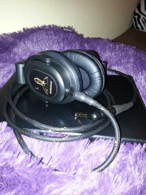

Grainger,
Sorry for the delay, the weather was b e a u t I f u l, so the wife and I took a drive down to Monterey and just kept going.
I didn't take any assembly pictures.  I tried to make it look as close to the manual as possible.  But here are some assembly notes I remember.
I hate the wool felt, spent most of the assembly time trying to separate the felt from the paper backing.  Half the time I just pulled it off and used my own glue dots.
I also added another layer of heat shrink for looks.  The adhesive heat shrink pushes glue out when contracting and it cools down to a whitish color.  I just covered it to keep the plugs neat.
A chop stick makes a great "burnisher" for the metal tape.
My stock resistor's weren't matched.  The ones I used as replacements were a little closer to the manuals value.
Here's a phone pic of the finished product.
Alonzo
Alonzo
Reply #4 on: March 23, 2014, 11:59:26 PM
Nice work!  The cable looks substantial yet it coils easily.
