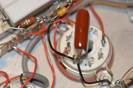

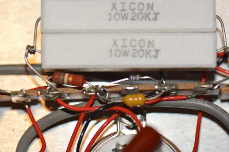

The voltage between H1 and H2 should be about 6 volts (one probe on H1, the other on H2).
With your black meter probe at ground, there is a voltage reference that elevates the 6V rail.
The last picture on page 31 shows how this works.  There are two resistors and the Z5U bypass cap, then a wire leaving the resistor junction and going to tube socket pin 9 on the left socket.  That is what you'll want to look at.  If the red wire going to A9 (I think that's the A socket) is grounded, you'd have issues with your "H" voltages.
As far as the rest of your issues, you have high voltage at your power supply, do you have it present at R7?
If you don't have an 0D3 plugged in, it won't get any further than this.

A9 has continuity to ground.  I am trying to trace the path and see where it is shorted but I am not seeing it yet.  Are there any tricks to find where a short to ground is occurring?  I am thinking maybe de-solder and check either side and then do the binary search thing with this technique.
R7 has about 482 VDC.
Very much appreciate your help with this.  This is my first electronic project so I am not well versed in circuit descriptions yet... indeed I had never soldered prior to this project.

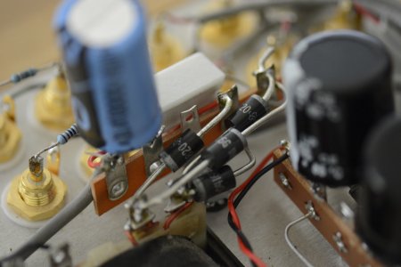

Can you shoot a picture of your FP-III that's the same as the one I referred to?
Offline Mwest
    • Posts: 8
Reply #4 on: March 24, 2014, 04:46:33 AM
Thanks again Paul,
I am uploading three pictures to try and cover the areas you described.  Also my initial miss wires were 1 & 2 on the power supply were swapped and the red wire was miss fed to 7 instead of 6.  Symptom of the miss wire was a blown fuse on the power inlet.

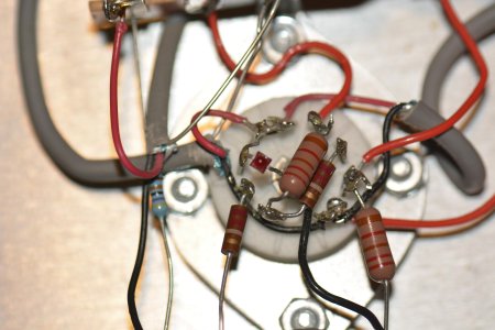

I would focus on why the twisted pair leaving the high voltage supply isn't providing voltage to the 8 pin socket.

Terminal 10 has power and terminal 5 is measuring at the expected 0 vdc.  Pin r7 has 482 vdc.  I am not certain why the interest into the twisted pair feeding the 8 pin socket. I resoldered everything related to the 8 pin socket and the twisted pair with no joy.

I think I may have found the problem.  Would you please look very closely at the picture of the 8 pin socket.  There is an indent in the hole at the center of this socket.  Mine appears to be clocked 90 degrees counter clockwise to the picture in my manual.  My guess is that I am not sending power across the center tube, which I believe you are referring to as 0D3.
Much appreciate you taking the time to help a newbie with his first project.
Sincerely,
Matt West
    • Posts: 20300
Reply #12 on: March 26, 2014, 07:25:05 AM
Yes, I didn't notice that at first, but you are correct.  This will indeed prevent power from reaching the rest of the circuit.

I am much closer.  Rotating the socket and re-attaching everything to it helped.  A lot of my voltage readings are now corrected.  I also had to swap to the smaller of the two center tubes to get it to glow and give happy voltage readings.
