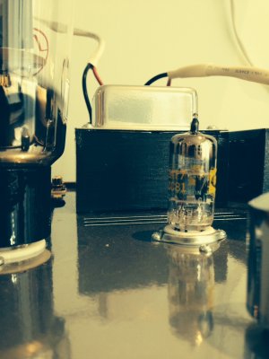

No luck. I reheated and added a little solder to all the 9 pin socket connections and all connections on board above it, plus the terminal strips that connect to it. They didn't look bad to start with. Anyway, the issue remains. It really feels like an issue with the connection between the tube pins and the base slots. I can make both channels play reliably by tilting the tube to the right in the base (see pic). Any other options to troubleshoot this?
Thanks.

I had a similar issue on my Paramour 45's, plus a nasty intermittent "finger nails on chalk board" growl.  Did everything you have tried to no avail.  I finally replaced the tube socket and problem solved. Of course my amps are much more experienced than yours!
The problem may not have been the socket and I just solved the issue in the process of replacing it.  But the end result was the same.
