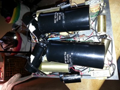

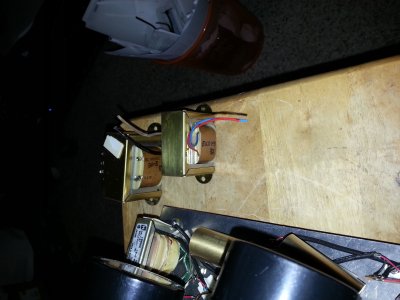

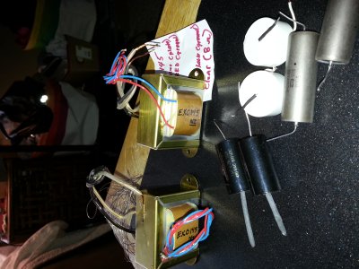

I couldn't leave well enough alone.  Burned some "sick time" from work to do some upgrades.  Amp sounds great but I couldn't resist tinkering.  Took out some bypass caps, replaced BH-5 Ni outputs with EXO-145 NI Litz.  This will play until Supremes are delivered, then will upgrade my Obligatto output caps.
Here are some pics; the upgrade parts, a before pic and a comparison of the output sizes.  I'll post a final after changing outputs and trying some bypass caps and silver wire.

Good god those obligatos are huge.  Excuse the dumb question, but which amp is it under all those caps?
Offline Alonzo
    • Posts: 462
Reply #4 on: March 27, 2014, 07:22:04 PM
45 parafeed, started out as a JE Lab 45/2A3 SE but morphed as the stereomour came out and I got a stereomour top plate, now I would say it's more single chassis Paramour II setup for 45's...mucho mucho goodness.
630V DC, nuff said  8)

Hey Alonzo,
I was just looking at my stereomour top plate on one side of my bench and the exo-145s on the other side (figuratively, of course) and I had to wonder if thosetransformers would fit the stereomour chassis as it is -- well, bingo!, perfect fit and plenty of room inside. So now if there will be no issues with adding a 5k opt to the stereomour with 45s, that's what I'm going to do. my guess is that there will be no problem, maybe just a small adjustment in the cathode resistor and maybe the power supply resistor. I had planned on using this amp in our quasi home theater setup, but have decided to go with the SS ACA amps or s.e.x., and the stereomour in my main system.  This is going to simplify things a whole lot, at least to begin with.
Nice going and let us know how those opts sound with some break in.
