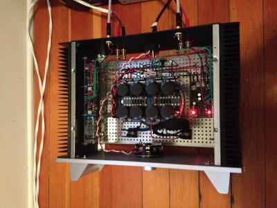

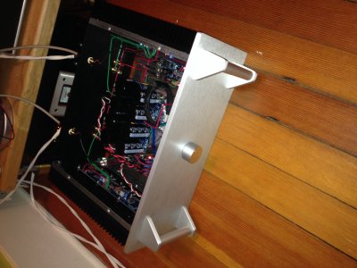

Ok I know to some it is sacrilege to play in the sandbox.  My latest project is a Pass Lab F4 clone.  It is an interesting amp since it has unity voltage gain.  I want to drive it with a SET amp.
So far I have built one channel in a parallel mono configuration.  In this configuration it puts out about 50W.
Source--->Extended Foreplay III preamp modified for 6SN7's---> Paramount 2a3 amp --->F4 in parallel monoblock configuration.
I tried both the 8 ohm and 16 ohm tap on the output transformer and listened to both with a variety of resistors across the Paramout output (12R, 15R, 20R, 22R, all Mills 5 watt resisitors).
Not surprising the 16 ohm tap sounded better. As for which resistance across the Paramount worked best, I think the 20R or 22R sounded best but there was not a big difference between all four. When the second channel is built and listening in stereo I may be able to refine this more.
As for my listening impressions. First it had plenty of volume, louder than I would want to listen at. The F4 adds very little to the coloration of the sound, except more power and the bass was very noticbly more present. Still warm and very detailed, much like my SET amp on steroids.
I also listened to just the preamp--->F4 combination and found this worked well also but the sound was much more alive with the SET amp in the chain.
The entire system was dead quiet no hum at all, even at loud volumes.
I look forward to trying it in stereo in my actual system (BeePre and SR45amp)

Are those boards from the diyaudio store?  I've been tempted to build one of those amps as they seem very popular on the forum.
Love the purple wiring by the way :)

Reply #2 on: March 29, 2014, 02:47:14 PM
Yes they are the boards from the diyaudio store
Deb

It really is a nice sounding amp especially when driven with a DHT tube amp.
Glad you like the purple wiring, I kind of have a thing for purple  :)

debK
If I may ask, what front panel switch did you use, and how did you wire it in?  I.e. are you switching the mains  directly?

Reply #6 on: April 03, 2014, 02:29:18 PM
I got the switch from apexjr.com.  I am switching the mains.  There is also a mains switch on the back, but i wanted somehting up front also.  The rails in the amp are 24V, perfect for the led ring light in the switch
