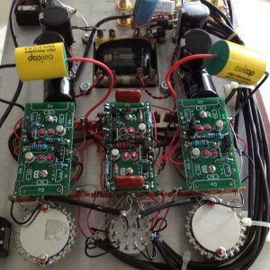

I turned on the system last night after a 10 day business trip... no music nor sound just static.  I just check under the hood and one of the LED light on the center board is not lit (D1 on the A side of the board).  How do I fix that?  Do I need a replacement part(s)?
See attached pic

The fist thing I always do is wiggle the tubes in their sockets, in case it's just a socket connection problem (trace of corrosion on a pin).
We'll need voltages in order to diagnose what's going on. Since most of the board LEDs are glowing, we know the power supply is working - so most important are the tube pin voltages. These are hard to get to, so for a first step try this: A) are the LEDs on the left and right sockets glowing? B) measure the voltages at OA and OB on each of the three boards. This will give us an idea of what might be wrong.
The puzzle is that the dim LED is a problem on only one channel, but you say both channels are not functioning. So there are probably at least two different things wrong. Check to make sure you have the selector on the right setting, cables are connected, etc. I know this seems too simple, but it makes things easier if we eliminate as many things as possible before getting deep into the circuit behavior.

Here's what I did: I removed all 3 tubes and with hit with the soldering iron on the center tubes socket pins.  The dimmed LED on the center board came back on!  Plug back into the system, I have MUSIC... 20 minutes later, the left channel start spitting and crackling, right channel is still playing music.  I checked the LEDs, and like before one if the LED on the center board is not working.  All the LEDs including both the sockets are on.
i plugged back into the system just to see if any change - No music on the right channel and spitting and crackle on the left
Here are some voltage measurements:
Left channel board - OA 67.6V, OB 66.7V
Center board - OA 84.5V, OB 84.6V
thanks
Right channel board - OA 68.4V, OB 67.4V
    • Posts: 5907
Reply #13 on: April 15, 2014, 06:02:41 PM
Good info!
It appears the shunt regulator is not working - on the center board, OA and OB are the regulated voltage outputs, which should be 150 volts.
I suspect those MJE350s on the reg board. Contact Eileen (spareparts...) for the replacement MJE5731A. I think there's a sticky somewhere about mounting them - the metal faces the opposite direction.
If this does not solve the problem, we'll search further - but it's still a good idea to replace those transistors.
Reply #14 on: April 15, 2014, 06:36:27 PM
Eh, e-mail replacement parts for a new board, and say that PB said he'd take care of it.
I'll throw a replacement PC board together for you - it is rough to retrofit the MJE-5731A's into the circuit, and we would be happy to help.
