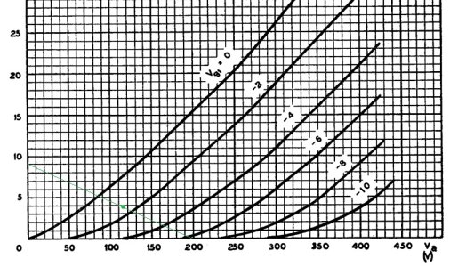

To make it fairly simple, we will start by assuming that:
1.  The high voltage supply available is 200V.
2.  We will keep the 22.1K plate load resistors.
3.  We will keep the 1.5V diodes for biasing.
200V and 22.1K allows us to draw the load line on the curves.  It hits (200V, 0mA) and (0V, 9mA) by Ohm's law with the minimum current across the 22.1K giving us B+ on the plate, and maximum possible current drawn through the 22.1K resistor from 200V to be 9mA.
Where this load line intersects 1.5V of bias is where the tube will operate in the Crack.  I have marked both the load line and the approximate location of this point on the attached image.  As you can see, the tube will draw ~4mA and the plate voltage will be up around 120V.
For the Crack, I'd like to see 75V on the plate, and by using the same strategy, I would estimate that a 50K plate load would likely hit that mark.
As far as performance goes, I don't believe that the extra gain that this tube offers will be helpful to the circuit, and going to the 50K plate load will increase that gain a bit.

Paul's post looks to me to be for the ECC32.  He suggests keeping the HLMP-6000 diode with the ECC32.  Reading through his post, I think he is suggesting a 50k Ohm plate load resistor.
The tube's output will be wiggling around the dot on the green line.  (Paul, tell me if I got this wrong)
The voltage on the plate of the driver is also the DC bias to the output tube.  This is why Paul is wanting 75V there.

1. Why does he want to see 75 volts on the plate?
It allows about half of the available B+ to appear from plate to cathode on the output tube.  It also helps define the maximum amount of heat that can be generated by whatever is under the cathode.
2. Is there any reason why I could not change the 1.5V diodes for biasing?
There are some other options, other LED's and other resistors.  I would try to keep the bias voltage above 1V if possible.
3. Is optimal performace gained by having tube perform at a linear point on the Vg (bias?) curve?
Yes, this is very important, but you need to pick the operating point *and* draw the load line.
From the little reading I have done it would be best to have the tube working at a linear point on this curve.  With a 75V plate voltage and 1.5V diodes for biasing, this point is not particularly linear on the ECC32.
It actually looks very linear with a 50K load.
However, if I reduced the bias to 0.5 V and maintained a plate load of 75V, a more linear point in this plot would be obtained.  Using Ohm's law (if I understand Paul correctly), I would require a plate load of about 23 K Ohms, which is remarkably close to the 22.1K of the stock circuit.

I think you'll get lower distortion and better overall performance with the 50K plate load resistors.

Yeah, I think you'll be happy with that operating point.
Generally, a good rule of thumb is to keep a plate load around 3x Rp to keep distortion reasonable, and 50K should get you there.
