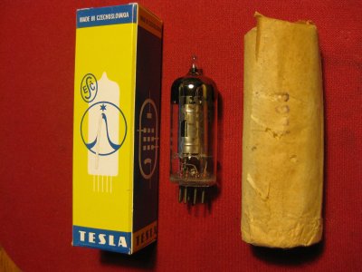

I stumbled across these interesting little tubes, the Tesla 1L33 made in Czechoslovakia. I got two sets of them, one are Tesla boxed, the other set came from the darkest depths of soviet military surplus and have the usual brown paper wrapper. The military surplus also seem to be marked with paint on the tip of the glass.  The 1L33 is a clone of the 1S4 tube so the Quickie can be easily adapted to run them by disconnecting pin A1 and B1 to reconfigure the filament heater layout.

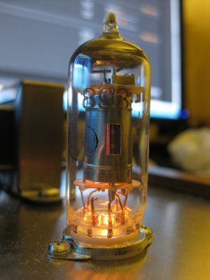

They have one interesting feature in that they have a small window in the plate so you can see inside, and what a shock it was to see those filaments glow! I had gotten used to the idea Quickie tubes don't glow but in reality they do, you just cant see it normally.
The build quality is pretty terrible, when you line the four up side by side the heights of the internals is all over the place, and the plates look like somebody formed them around their pinky finger.  There is one issue though, they are hilariously microphonic.  If you flick the tube with your finger they ring loudly and after a few seconds the ringing will fade out, then fade back in, and out, and in, and out, and in.  No exaggeration i went and made a cup of coffee and came back to find they were still oscillating. If you should happen to be using a stepped attenuator on your quickie good luck to you, it will sound like a wind chime whizzing around inside a tornado.
