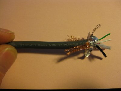

It could possibly be your RCA cables picking up the noise. I had a similar noise which disappeared when I found out by accident that a twisted pair of connecting RCA leads resulted in the noise disappearing. Thinking on how the internal rca cabling is braided to help cancel out interference I tried reconnecting without the twists = hum, then reconnecting with some twists put in with good results.
 It might not work but its an easy thing to try and you never know it just might be that simple to fix.
(https://forum.bottlehead.com/proxy.php?request=http%3A%2F%2Fcdn.head-fi.org%2F7%2F7a%2F900x900px-LL-7ab2aec2_0092.jpeg&hash=3e0ef8569287b83ec1fec5d7e3f8b0b88ec0a737)
