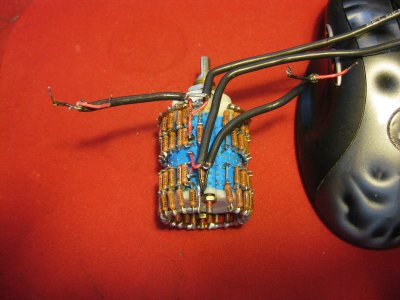

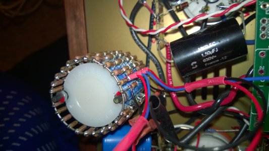

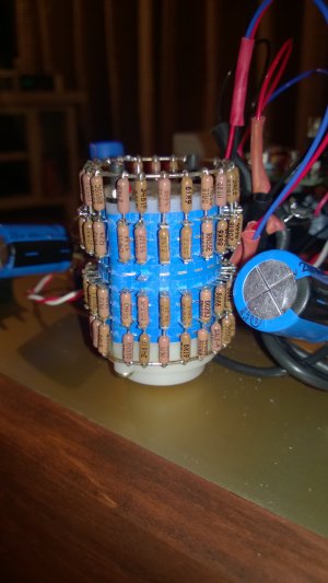

I've just added a Dale resistor stepped attenuator to my SEX. Reading some comments over on the Crack thread at Head-fi there's discussion of shorting the earth. Currently I have the earths of the left channel shorted (in and out connected) and the right channel earths shorted (in and out). The left and right channel earths are currently not connected. Should they be?
Here are some average pics I took after installation. Hopefully they show enough.
Reply #1 on: April 24, 2014, 04:34:27 AM
Nope that doesn't apply to the S.E.X. amp, the Left and Right channel are kept separated all the way until the headphone socket.  I'll post up a picture of the attenuator wiring when i get home from work..

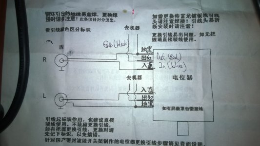

Hopefully this will help as its the complete unit with input & output wiring. The section closest to the chassis was the right channel on mine, red wire from the input RCA connects to the upper most terminal, output red wire to tube connects to the lower, and the black wires from both the Input and Output connect to the ground ring at the very bottom.
The left hand channel is a mirror image, ground ring at the very top, then the output, then the input as you work down towards the chassis plate.  Note none of the channels are connected to each other, they are totally independent.
Only other thing to watch is the shield for both the input and output wiring should be joined together, but should not make contact with anything else. It should terminate to the chassis at the middle position of the tube socket standoff.

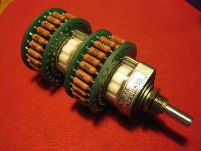

Oh don't worry i suffer from a bit of OCD too, all the resistor colour codes have to be orientated the same way so you can read them from left to right, it has to match the orientation of the labeling on the PCB, all components have to sit flush.  The attached pic says it all really, all the "DALE" marking and resistance codes had to be the same, and i had to ensure they were all perfectly centered between the two PCB's. That's after resistance matching them between left and right channels of course..its fun being me.
