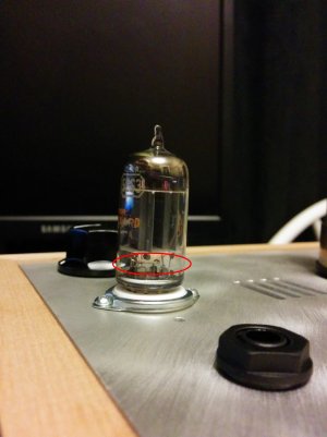

Offline casctu
    • Posts: 9
Reply #4 on: April 26, 2014, 08:11:53 PM
I've attached a picture - only the section circled in red is lighting up - do I need a new tube?
« Last Edit: April 26, 2014, 08:19:51 PM by casctu »
    • Posts: 20305
Reply #5 on: April 26, 2014, 08:19:33 PM

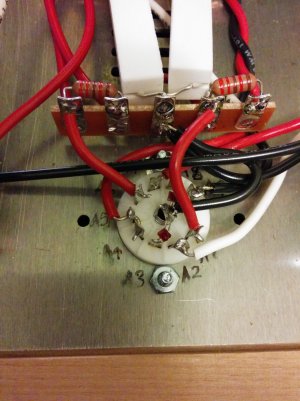

OK, both halves are lighting.
Can you post a photo of the 9 pin tube socket wiring?
Offline casctu
    • Posts: 9
Reply #6 on: April 26, 2014, 08:25:12 PM
Sure, no problem. Not sure why in hindsight, but I soldered the LEDs so they would be facing up. If necessary, I can resolder them and flip them over so it is clear which way the stripe is facing. If there's a specific area you need a better view of, let me know.
« Last Edit: April 26, 2014, 08:34:21 PM by casctu »
    • Posts: 20305
Reply #7 on: April 26, 2014, 08:35:10 PM
The wire leaving A1 goes to terminal 5, not terminal 4.
You should have sweet tunes after you move that wire.
