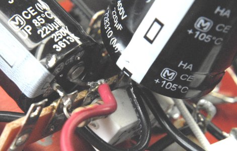

I have a steady 50 Hz humm that is always present
and disturb my listening enjoyment.
I cannot hear it when the music is playing,
but between track I can clearly hear it.
I have checked the ground connection, the interconnects in case they pick-up line voltage.
I have changed the tubes, even if I don't think that could be the problem.
The level of humm as a fix level and is not affected by the position of the volume control.

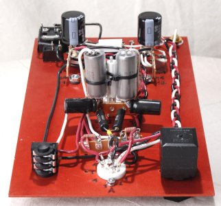

I am posting some pictures in case you can see something suspicious.
What and where should I look for.

Reply #3 on: April 30, 2014, 02:40:17 PM

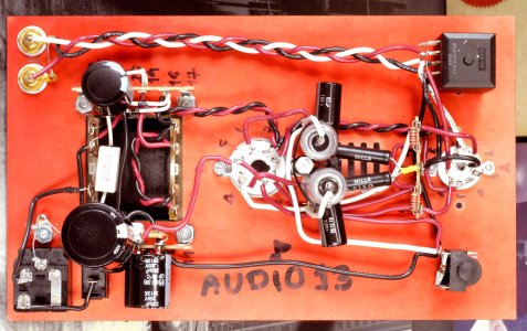

Shouldn't there be three caps in the power supply?
Reply #4 on: April 30, 2014, 02:44:04 PM
Yup, Mark called it. You forgot one power supply cap.

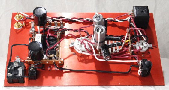

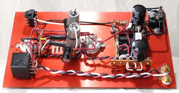

That's a bit weird!   Here are the final pics before shipping....
(https://forum.bottlehead.com/proxy.php?request=http%3A%2F%2Fi.imgur.com%2FeLb3oE8.jpg&hash=1a00a5b20e9fec66e0967f3f8f192ac41ff57598)
(https://forum.bottlehead.com/proxy.php?request=http%3A%2F%2Fi.imgur.com%2FQyLEdWQ.jpg&hash=2a4bf5e70bf8293ad7ee328d4e6484b567d52e49)
Was there a cap loose in the box?  Dazed and Confused,
Geary

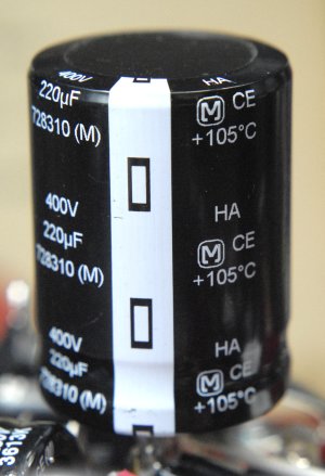

Yes, now that I think of it, there was a capacitor in a Ziplock type bag.
My problem now is...
I don't know where I've put it ? ? ?
I just finish looking for it, but no luck.
What is the value (uF) of that capacitor?

Hi Guy 13,
I checked my manual. Looks like the missing cap is of the same type of the other two sitting nearby, so it should be a 220uF 250V one.
Are you living in Saigon? You should be able to find a replacement easily in a local electronic shop.
Let me know if you need my help.
PH

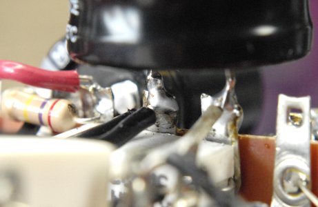

I wonder if the capacitor that I saw in the Ziplock bag was put in there by my wife's aunt,
because she brought the Crack in a large hand bag that was inside her luggage.
I might have unsoldered and fell and she picked it up and put it in a zip bag.
I will look again for it, I've have missed place it, if not, I will not loose my time and buy you, mind you, if I could use my   220uF /360V Hitachi capacitor if would be great because I've got hundreds of those in my warehouse and they are not much bigger than the original.

It's a fact that one capacitor is missing, but Geary is in no way responsible for that,
it's my wife's aunt that took the Crack from a very well packed FedEx box that Geary put together
and put it (Believe me or not) in a hand bag within a box of clothing as shock absorbent material.
She probably broke off the capacitor when she transfer the Crack from the box to the hand bag
and to a new box.
I am sure she did not do it on purpose, but by ignorance and lack of experience.
I found a capacitor and on Monday it will be soldered by a young man without shaking hands like mine.

Reply #14 on: May 01, 2014, 12:42:24 AM
I can see the third power supply cap in the first of the two "pictures before shipping" (horizontal at the back on the left).  So Geary installed it.
However you might have received it in a plastic bag if it somehow fell off before delivery.
A photoflash cap should help you troubleshoot this problem.  Try some jumpers and attach the cap with the negative lead on terminal 12 and the positive lead on terminal 13.  Both of them go in the upper openings of the terminals when you get to soldering.
I can't remember about photoflash caps.  I think they dump energy quickly, which is a good thing.  So for testing they should be fine.  Probably good permanently.  Although this is the spot you can put in a film cap for an upgrade so keep it in mind.
