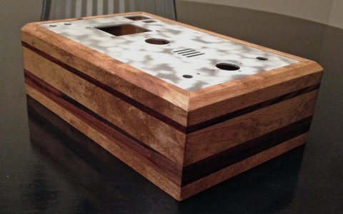

My Crack came over a week ago and I finally got a chance to start working on it. I built the base first. I decided to use the wood that came with the kit and add a rosewood inlay. I used Danish Oil (walnut) for color and finished with BriWax. I polished it with a car polisher. Now on to the plate modification to accommodate a hum-dinger virtual center tap. I will use a 220 ohm multi turn wire wound 2W POT.

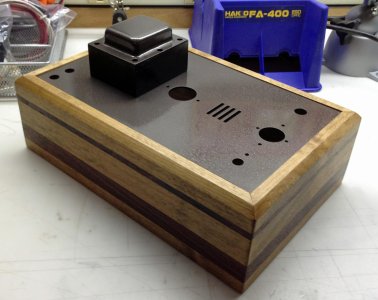

I decided to paint the top plate and transformer bell. I also painted the transformer laminations with high temp paint. I used scotch brite to smooth out the lacquer, cleaned with denatured alcohol and applied a hammer coat paint. Now on to the actual build.
