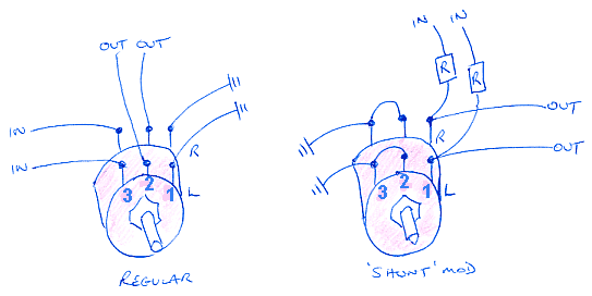

Hi everyone,
My crack kit is on its way and I've been thinking of ordering a new volume pot (mainly for channel balance at lower levels, otherwise Alphas are great). Goldpoints seem nice but they're very expensive to order from the UK.
Then I came across this 'shunt mod'
http://www.world-designs.co.uk/forum/showthread.php?t=5795
Has anyone tried it? It would probably not completely solve the channel imbalance at low levels but I could fiddle with resistor values - eg 47k series resistor with 10k pot to reduce the gain by 15dB as suggested in the article - and play with vol pot turned up a little more and get out of the pot imbalance zone. Would these values work with the Crack?
An alternative would be a VALab stepped attenuator but I quite like the idea of reducing the gain and the cost-effectiveness of the shunt mod.
I would love to get your thoughts on this.
Thanks a lot
Thomas

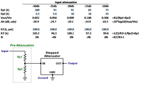

Thanks PB - here's my take to maintain 100k input impedance using common resistor values (please let me know if I am wrong!)
Paul Birkeland
Global Moderator
20302
Re: Volume pot shunt mod
Reply #9 on:
May 12, 2014, 08:08:26 AM
Yeah, that will keep you in the ballpark.
