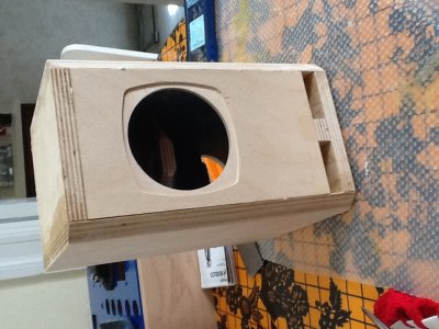

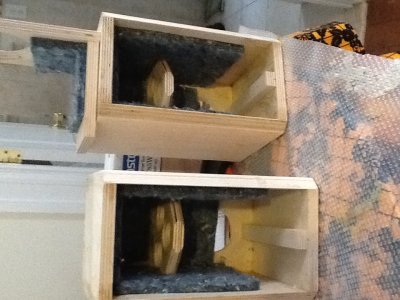

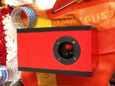

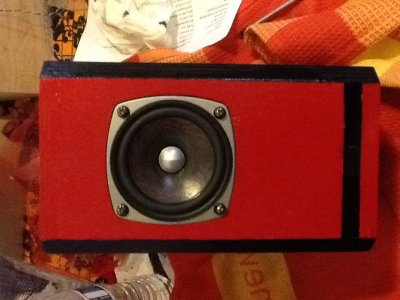

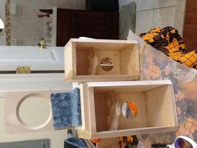

Bought a pair of the fonken flat pack speakers from planet-10 for my desktop at work. Pretty easy to glue up, cut and glued included felt lining. The wood was nice baltic birch. Used the 3" wk driver because i had tried the wk 6.5" and it had tons of bass. I like the fonkens porting forward as there was no wall behind the speaker in my office. Painted them up in work colors. Took about a month. Let each glue harden overnight and each coat of paint to cure 24hours. 2 color painting was the hardest for me as i dont have a steady hand - kept having to fix my fixes. Been running the speakers hard all day. Finally starting to sound decent. Im sure they will really open up in a week or two.
