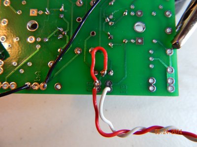

I found that the MJE transistor center leg (collector) for the left channel did not have continuity between it's pad and the OB pad on the board.
I put in a jumper between the 2 pads (picture below).
All resistances and voltages are "spot on" and it sounds great!
Adrian C.

Yeah, 0V at the output is most often that pesky center leg.
While I don't recommend the jumper, I do recommend not using much solder, but heating it until you see it suck into the board a little bit, which means it is wicking along the center leg through the plated hole in the PC board.

PB:  I really tried to not get too much solder.  We'll see how this jumper works. Maybe it will last forever and work great.
Adrian C.

Paul/Doc: Actually I was tempted to call the PC Board a little bitch.
There was no connection (continuity) between the two pads and I did not want to order another board and strip this one (or maybe just buy a new C4s), so I did it the DIYer way and got the job done.
Adrian C.
