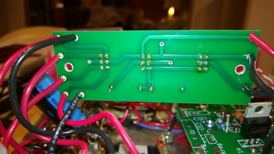

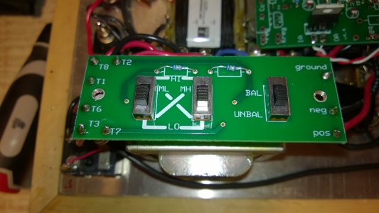

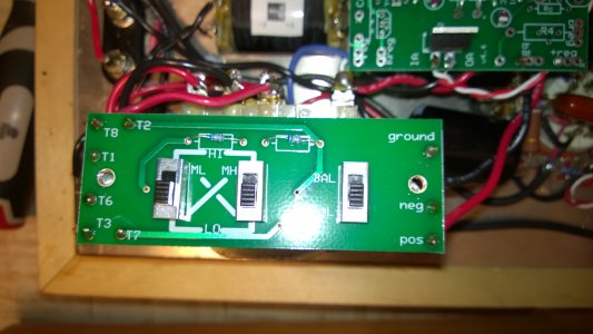

Before going into significant testing of the circuit (which was previously fine) I decided to use a separate wire bridge a few things to see if I could isolate the part of the circuit that was at fault.
I pretty quickly discovered that the impedance PCB (or one of the components is indeed the issue). If I bridge a wire from one of the positive input terminals of the right channel impedance PCB to the positive output of the same PCB (i.e. bypassing the PCB and mounted components), the sound comes good. Throwing both / either of the impedance switches, however, has no impact at all so it's not just a faulty connection on one of the inputs as I briefly suspected.
In his own words, the owner of the amp forced the switch back into place when it "fell off". I can't see any signs of damage to the PCB and all 6 pins of the switch are protruding through the PCB and are securely soldered.
There is no visible sign of physical damage to the PCB, but I'm wondering if the forceful reinsertion of the switch could have broken one of the traces in the PCB. I've attached images of the top and bottom of the culprit PCB.
    • Posts: 20297
Reply #5 on: May 25, 2014, 07:12:36 AM
Hmm, sounds like replacing the switch in question would be the prudent thing to do.
