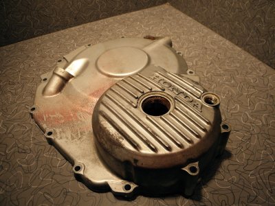

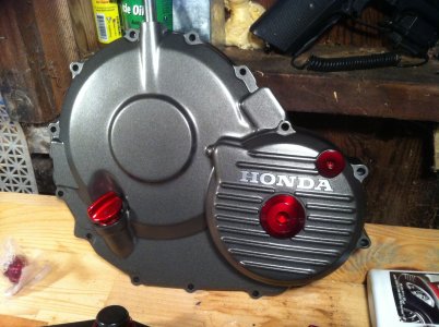

Here's a before and after of an engine cover that I blasted, cleaned with lacquer thinner, shot with VHT engine enamel and baked for an hour at 200 degrees. The red stuff on the before was apparently overspray, complete with green primer under it. Took a little extra time but the soda blasted through all of it. Sorry that I didn't get a pic of the blasted surface. The red parts on the finished cover have Duplicolor and Krylon "fake anodizing" on them. Back in the day us old timers called it candy coat.

Love the polished Honda logo, looks great  :)

The logo was simply sanded out with 100 grit wrapped around a narrow stick, with painter's tape covering anything I didn't want to touch with the sandpaper. I agree that a compressor is high on the list of must have tools, along with a drill press and a big bench vise. And a BFH, of course.

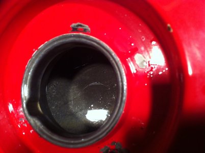

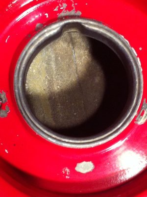

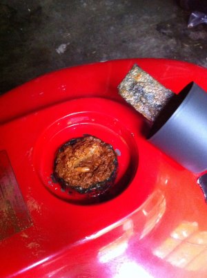

A jug of phospate cleaner works great on steel too. Lifts light rust right off and leaves a grayish layer of zinc phoshate on the steel, aka Parkerizing. I used it on the inside of my gas tank after de-rusting it.
Total process was soak with lacquer to remove varnish, gross rust removal done with electrolytic rust removal with a washing soda solution and steel electrode (1st pic - yuck!), rinse with mild oxalic acid solution to remove a bit more rust, soak with warm zinc phosphate solution to do last rust clean and rustproof (2nd pic) and spray with a coat of fogging oil to keep it nice until the first gas fill (3rd pic)

holy smokes, that was some rust!

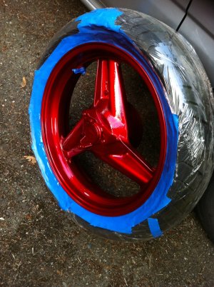

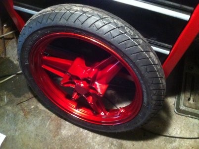

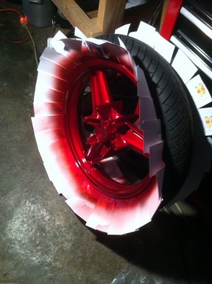

Yeah it was fairly crusty inside, but only one tiny dent. Yesterday's prep and paint was the wheels shot with Krylon "X-metal" (which I guess is the comic-book-superheros-on-film generation's version of what we called candy apple red back when X-Men and Iron Man stories were only a quarter and printed on paper), transparent red over silver base coat.
