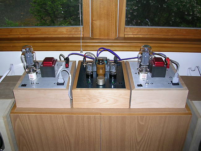

I am using the Fostex 208E Sigma in an open bafle (as part of the Basszilla speaker) and driving them with 300B Paramounts.  Sounds fine and plays plenty loud for me.

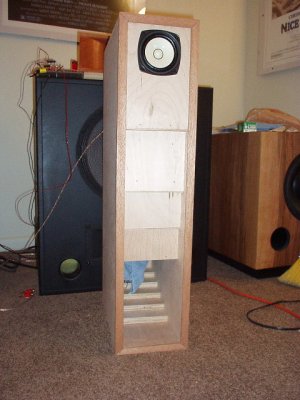

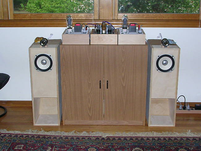

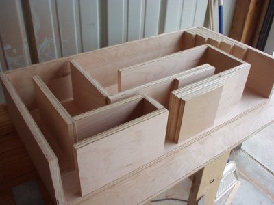

 i have built a jericho horn which is similar
and highly recommended--the basis being the fostex 208esigma--a very nice speaker-i added a ribbon tweeter. a fountek neocd2 --howie
