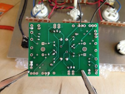

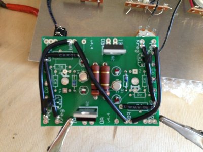

Hi, just fired up the S and found a voltage issue. At 1A and 1B I get 410. At 0A I get 221 but at 0B (and of course 14) I get only 62. If I remove the wire on 0B I get 410. At K reg I get 2.5 (A side) and 0 on the B side. Have 122V AC at the wall.
Is it just a bad Q2 transistor? I attached pics of the board, but everything looks good (I think).
Thanks for any help.

kreg is the 431 chip witch if correctly wired drops exactly 2.5 volts. Apparently it is shorted to ground, possibly at the tube socket?

Great call on the tube socket Paul.
