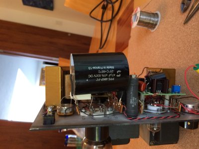

on: June 01, 2014, 03:15:03 AM
Big :)

Did you get a big enough cap Xavier ;)

Took me a few hours to do it in the six amps. Also adjusted the voltages of the driver tube. Right off, without any break in the improvement is brutal.

That's a lot of work shoe horning them in there!
