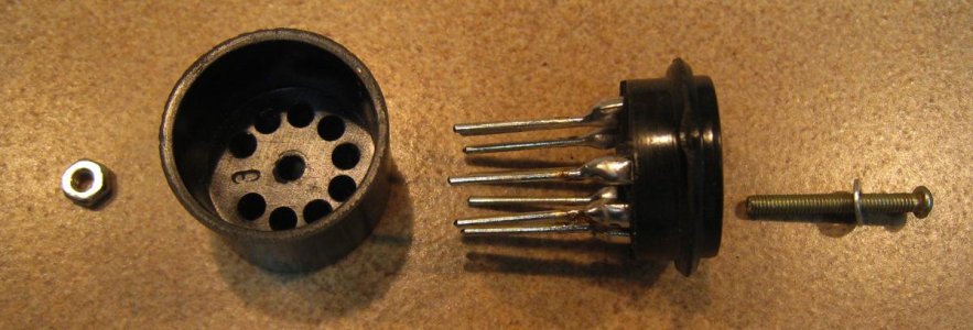

Reply #10 on: June 03, 2014, 10:19:32 AM
Here is the 9 pin socket saver opened up. Be sure that this is what you want. I have used these in the past but not for building an adapter.  :D

Reply #13 on: June 04, 2014, 06:00:30 AM
That might work if you are careful. I have worked with these pin savers before. As soon as you heat a pin to solder it, it comes loose from the socket. The pins are only soldered to the socket and come off easily. Using a PCB will make it easier. You could just start with the correct diameter pins, cut them to length, and bend a loop at the top to solder to. Then insert the pins through the PCB and solder. You could also use a 9 pin socket to hold the pins in place during soldering. That way the pins will all be in correct alignment. Simply put the pins through the PCB and insert them into the socket and then solder to the PCB. Attaching the octal socket could be a little tricky because octal tubes have a center alignment post. You may be able to get a insulating tube of the correct diameter and glue the octal socket to the tube, solder the jumper wires, and then glue the PCB to the other end of the tube. Just food for thought.
