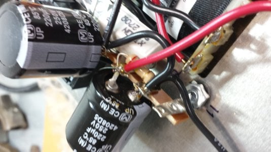

Hi,
I completed my Crack build, reviewed all the wiring and did the resistance checks. I ran into one anomaly and I want to ask for some assistance. When I do the resistance check on terminal 13 the meter starts around 20 mega ohms and drops from there. Is there something I should be looking for in the power supply area? The other varying resistance checks (terminals 1, 2, 4, 5) followed the notes in the manual. All other resistance checks were spot on.  As a result of this I have not done any voltage checks yet. I will try to include a picture if that helps any.
thanks,
Bob

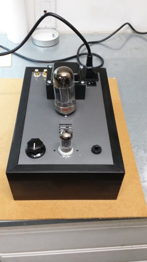

OK I did the voltage checks and everything checked out fine so I plugged in an old portabel CD player and took a listen. With cheap headphones and the poratble it sounded great. Had to see how my HD600s woudl sound and they were wonderful. Wow I want to get this into my system but I have to finish the base.
Yes anouther happy crack fanatic.
Here is a picture of the completed crack.
    • Posts: 20302
Reply #4 on: June 12, 2014, 07:27:05 AM
That turned out great!
