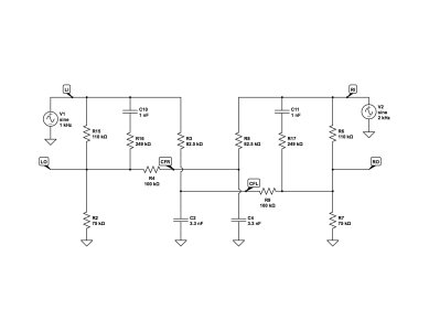

Well... I did some pretty heavy research. I analyzed the classic cross-feed circuit (below) and found some fundamental issues. For instance, in order to get the proper delay (0.5ms to 1.0ms) you need to use a resistor / capacitor filter which also acts as a low pass filter with a cutoff frequency of 585 Hz. This translates to more than a 30db drop at 20Khz. Consequently, only the low to mid frequencies are cross-fed. To compensate, the designer of this particular circuit put a high pass filter on each side, boosting the primary signal. This is an artificial solution since these frequencies are not cross-fed into the opposite channel. I discovered that the real difficulty in designing this type of circuit is how to generate a long and accurate analog delay. I experimented with the shunted transformer circuit but there is a limit there as well. The longest delay you can get with a max frequency of 20Khz is 25 microseconds. This is not enough delay to even simulate the difference in sound across the separation of your ears. Rather than trying to find a circuit solution, I evaluated a digital plugin. I used HiJack Pro and Redline Monitor to simulate near field monitors on my headphones. While the sound was a little more forward, it sound more focused and less open. It also seemed that I lost some fullness and dynamic range in the low end. After all this I decided to just enjoy my Crack and Tesla T1s just as they are. If anyone has another solution for a full and open forward soundstage please let me know. I do like to experiment.

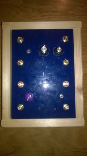

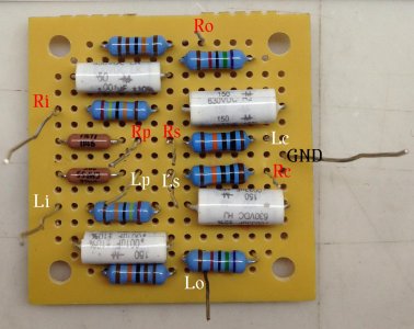

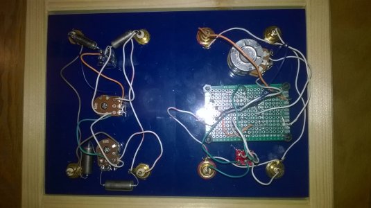

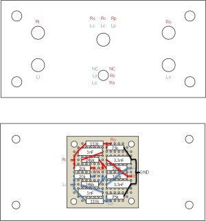

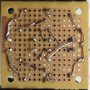

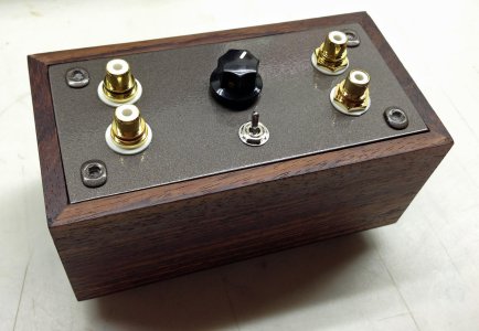

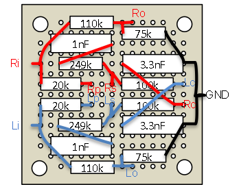

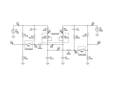

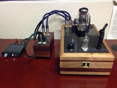

Well... I had some time on my hands so I actually built the Soundfiled Simulator from PB's link. I made some slight modifications to the circuit based upon recommendations I found. I also moved the POT to allow the actual soundstage to be adjusted. I also made use of my Bottlehead experience in designing the chassis. I was not expecting much but when I plugged it in and adjusted the soundstage, I was very surprised that to my ears the filter actually opened up the sound. It did not move the sound very far forward at all but it definitely was more pleasing. There is a 4.5db loss with this circuit so it also pads the source slightly. At this point I will be using this little box and giving it a more critical listen. Thanks PB for the link. In case anyone else wants to try this little circuit, I have posted a few picts on how to build it. I also have top and bottom plate layout files and the circuit board layout as well if anyone is interested. Enjoy!
Update: I updated the schematic to the actual values I used. I found an error in the original post.

OK, Perhaps someone can enlighten me. My engineering analysis says this thing should be marginal at best, but it sounds fantastic. Now that I have had more time to play with it, I can honestly say I love the sound. It is indeed more forward. Not only that but there seems to be added clarity, which is exactly opposite of what I would expect. According to simple analysis and verified through simulation, this thigh should be a little darker but that is definitely not the case. I even tried it on a different amp with similar results. I had two colleagues give it a listen and now they both want one. One has already asked for the circuit and plans on building it. The engineer in me keeps looking for the reasons why. If anyone has a little time, perhaps you could reproduce this circuit and let me know what you think.

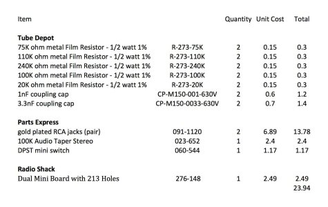

The cost of the parts is about $25, not including the enclosure. I used all 1% metal film resistors and Mallory Coupling caps. As always, you can upgrade the parts. Here is the BOM

At low frequencies, sound goes around the head to both ears, with a time delay difference that is perceived and with little difference in loudness. The RC lowpass filter creates the delayed cross feed.
At higher frequencies, the ear/brain becomes less sensitive to phase differences, and the head blocks more of the sound from the far side. The ear/brain at high frequencies thus relies more on loudness differences to detect location.
