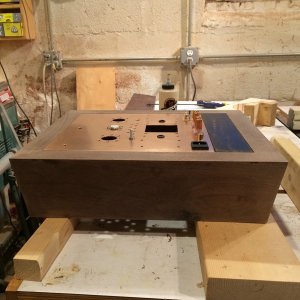

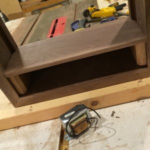

Making surprising progress in between bike rides!
Base is 8/4 solid walnut with an ebony-topped section at the rear that will hold the Triad filter chokes in a separate compartment. Top plate is copper, copper binding posts have been in the hoard waiting for an appropriate project. Coupling caps will be Mundorf silver-oil...

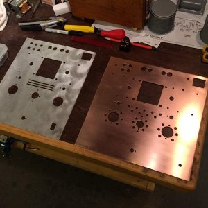

I really like the look! how do you cut the copper? Where did you get the plate?
Bottlehead Stat headphone amp
Offline pRC
    • Posts: 22
  • Demented creator of il monstro...
    • cognitivevent.com
Reply #7 on: June 25, 2014, 08:58:03 AM
A couple of tips - You can order copper plate from McMaster-Carr or onlinemetals.com -- I just use the standard size of 12 in x 12 in, so no outside cutting needed. Online metals will also do custom cuts.
If I remember correctly this panel is 13 gauge, which is plenty thick for this use; I ordered several plates last time I bought and had this one already on hand. Circular holes are drilled with an Irwin step-bit, square holes are drilled out inside the desired lines and then squared up with a file and sweat equity.
Even being OCD about keeping the drill press surfaces clean, you will scratch up the copper a bit as you work (the back side has all sorts of scribing for hole placement before center-punching all the holes). I use a pad sander and fine sandpaper to remove scratches, then work up through fine scotch pads to get a semi-gloss finish. You can also polish with semichrome if you want shiny.
Unprotected copper will patina over time, which I like, but you may want to spray on a clear coat immediately after polishing if you want to keep it looking like fresh copper.
If you are placing pairs of jacks or binding posts that have a skirt, you can just drill one of the holes a tiny bit bigger than the other to give you some fudge adjustment for getting them exactly aligned.

...and another picture - the OEM bottlehead top plate with the 12x12 copper plate. I have to say again that the OEM plate is a very nice part, beefy and well-finished. I went ahead and drilled a hole for the volume pot I will be leaving out of the build for now (this will have 2 inputs with a rear switch and be driven from a preamp) - I plan to cover the center hole on top with the square Bottlehead logo plate, up front and proud.

Reply #13 on: July 05, 2014, 03:31:40 AM
Made good progress this week and have the new amp working - had normal measurements at all points during checkout, with the exception of a bit high B+ due to choke and final cap changes in PS...
Changes to circuit:
* Bottlehead output impedance switch kit
* 2PDT coin-silver power switch - wired in parallel
* Triad CX-7 chokes instead of 270R in PS
* Mundorf 33uF film cap instead of 100uF electrolytic in final PS stage
* 4PDT coin-silver switch for dual inputs at rear of chassis
* Fixed 75k ohm input resistance - tantalum
* Mundorf silver/oil coupling and parafeed caps
* Mundorf 22 ohm power resistors in cathodes for 2A3s
* Caddock 249K resistors - 2A3 grid to GND
Still need to tune the hum pots, but the hum is low on the Azura/Lowther front horns and I though I would let it burn in a bit first with the Sovtek 2A3s; I do have some other tubes to try in the wings as well. Will also go back in and check for tank resonances at c2 in the PS (the 33uF film cap).
Thanks Paul Joppa and Doc B for a fun kit that sounds great!
Here are a few pics --

Reply #14 on: July 05, 2014, 03:37:57 AM
Wow! What a beauty!
What did you use to cover the chokes? Looks very nice!
