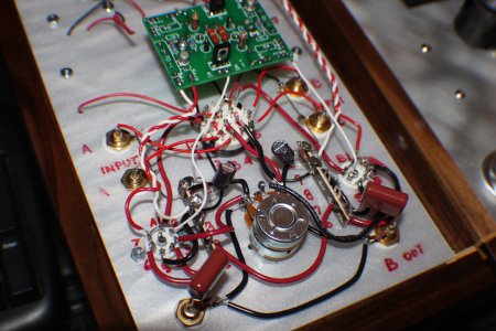

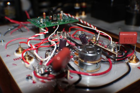

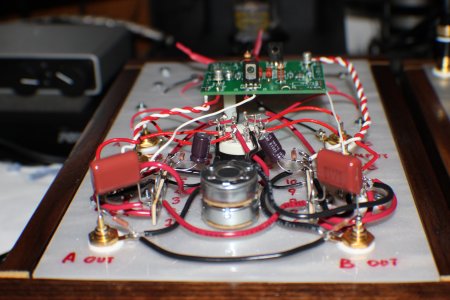

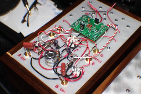

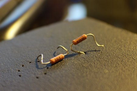

I need some assistance with my new Quickie bottleheads ,I received the kit few days ago and just finished building it,I took my time building it but my latest creation is dead silent ,
here are some voltage measurements and some pics ,any idea ?

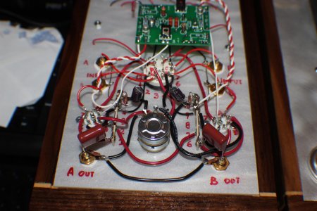

here it is ,no PJCCS

If you look at the resistance measurements in the manual you will see that 4 and 9 should each read 1.07K ohms, the exact value of the resistor that goes between 4 and 5 and between 9 and 10. So if you are reading a very high value there and the voltages are not right there are three possibilities:
1) the resistors are the wrong value. You can try measuring the resistance right across the resistor leads, from pin 4 to pin 5. If it does not read 1.07K or close to that the resistors may not be the right ones.
2) the resistors are not connected. If the resistor reads 1.07K but the resistance between 4 and 5 reads a really high value the resistor must not be attached well enough to conduct.
3) The resistors are connected at both ends, but wired to the wrong terminals. A visual inspection is the easy way to double check that.

both of them are 473 omh
Dale RN55D 4753F 1333
    • Posts: 9793
Reply #12 on: June 17, 2014, 01:03:22 PM
Those are 475K ohms. Sounds like those are the resistors that should be connected across the RCA output jacks, and that you may have the 1.07Ks installed on those jacks instead of at terminals 4 and 5.

Reply #13 on: June 17, 2014, 01:09:01 PM
yeap , ...I should check them before installation -both look very similar ,it's all my fault
    • Posts: 9793
Reply #14 on: June 17, 2014, 01:15:49 PM
We all make mistakes. That's a part of the process. Luckily the terminals are close enough together that you probably have enough lead length left on each resistor to fit in the proper location. Judging by your measurements a resistor swap ought to get things running right.
