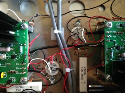

Reply #5 on: June 25, 2014, 06:59:45 AM
Can you post a photo of the wiring around the 9 pin sockets?
Offline Jeroen
    • Posts: 44
Reply #6 on: June 25, 2014, 07:00:27 PM
Hi Paul,
Hereby the photo's.  I hope you can find something I did wrong..

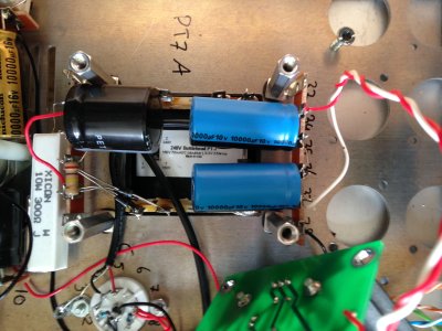

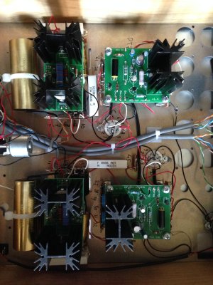

The next thing I would want to check is the voltage at the "r" pin of each TL-431.  Also, could you carefully unscrew the 4 screws holding down one filament regulator board, tilt it up, and take a shot of one of the power supplies?
We'll narrow this down sooner or later, thanks for your patience!
Offline Jeroen
    • Posts: 44
Reply #10 on: June 28, 2014, 04:01:30 AM
Hello Paul,
I measured 2,45 volt on pin R of the TL 431 on the left channel, 2,55 v on the right channel.
Hereby the requestef photo of the power supply.

Offline Jeroen
    • Posts: 44
Reply #11 on: June 30, 2014, 04:27:33 AM
Forgot to post the picture..
