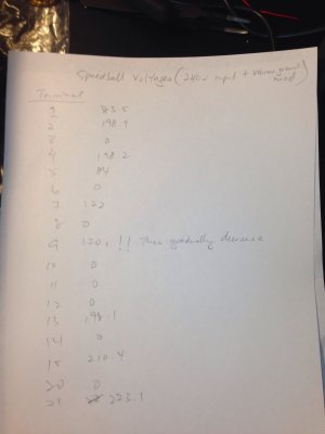

My Crack works ok before the installation of Speedball. After installation, the voltages appear fine except for terminal 9, which starts high (180s) and gradually decrease. Upon listening, the left channel is dead. :(

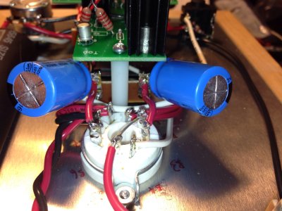

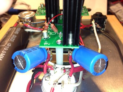

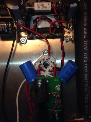

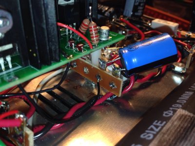

Just a thought, a short between B5 and B6? Happens for example if leads are too long, at the sockets they might rather easily shift. Pictures of the octal sockets solders and the adjacent termnal strip available?

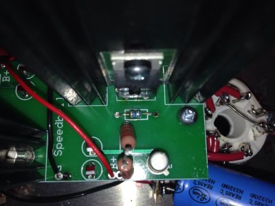

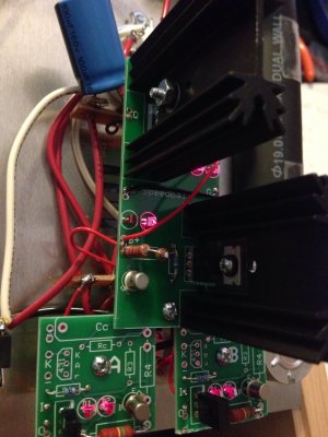

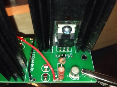

Here are the photos of the octal socket and terminal 9. I've also attached the voltage readings.
Meanwhile, I'll reflow 9U.

More photos of the octal socket and the terminal strip.

Try reheating the center leg of the TIP-50 feeding T9.
Also, just to double check, you did install the thermal pads and shoulder washers on the TIP-50's?

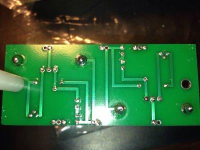

Reheated the center leg of the TIP-50 closest to the volume pot on the right. A few seconds after switching on, both LEDs are now not working and there's some sparking under the PCB. I switched it off immediately. :(
    • Posts: 20302
Reply #10 on: August 28, 2014, 03:37:20 PM
Sparking under the PC board would indicate a loose connection or a loose solder blob shorting out components.

Hmm I'm not sure where the problem is under the PCB (right side of the picture). Here's a photo of the soldering job of the TIP-50.
    • Posts: 20302
Reply #14 on: August 28, 2014, 04:07:07 PM
Throw it back in and check voltages.
